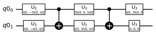

Given that the
$$\sqrt{iSWAP} = \begin{pmatrix} 1 & 0 & 0 & 0\\ 0 & 1/\sqrt{2} & i/\sqrt{2} & 0 \\ 0 & i/\sqrt{2} & 1/\sqrt{2} & 0 \\ 0 & 0 & 0 & 1 \end{pmatrix} $$
then we can use the decompose method in qiskit to get the set of elementary gates that would be implement on IBM hardware, which comes out to be:

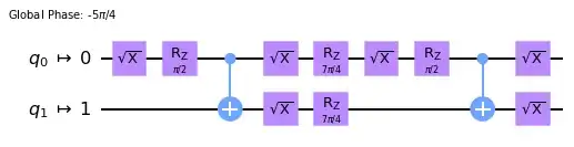

You can use quirk to do the something similar I believe. Now, recently IBM changes its native set of gates to $\{ CZ, ID, RZ, SX, X \}$. So to see how this being implement on the hardware you can use the transpilation method. Which will transpile the above circuit to the following circuit on 'ibmq_athens':

And the transpilation process can be done as:
from qiskit.compiler import transpile
provider = IBMQ.load_account()
Circuit_Transpile = transpile(decomp, provider.get_backend('ibmq_athens') , optimization_level=3)
print(Circuit_Transpile)
