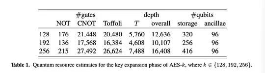

The authors construct quantum gate implementations of AES-128, AES-192 and AES-256. They Do it with Clifford+T gates "as the underlying fault-tolerant logical quantum gate set." Table 1 has their gate estimates and qubit estimates for the key expansion.

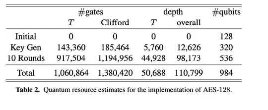

Table 2 has the quantum resource estimates for the AES-128 implementation:

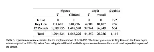

Table 3 has the resources for AES-192:

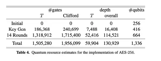

And Table 4 has the resource estimates for AES-256:

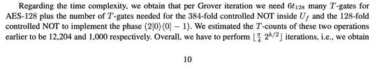

The key paragraph is at the bottom of p. 10 and the top of p. 11:
What I'm confused about is how we actually implement a 'Grover iteration' on a suitably large quantum computer. If we were to use a scaled up version of the superconducting quantum computers with artificial atoms, then the qubits are the wires and the gates are radio pulses that are fed into the circuit, right? So does each "iteration" mean that we play the gates from beginning to end $1.19 \times 2^{86}$ times?
If we do need to play the gates $1.19 \times 2^{86}$ times, do we store the results of each of those iterations in a classical computer that's controlling the quantum computer, and then take the result that was selected the most number of times, or do the results accumulate in the quantum circuit itself? If we accumulate the results, then don't we also need to have room to store $2^{128}$ 128-bit solutions to see which one comes up the most times?

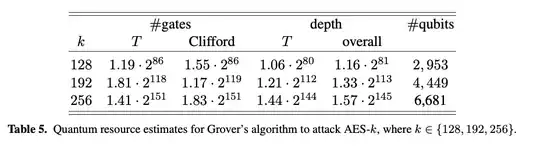

Here is Table 5, which computes the time resources required for attacking AES with Grover's algorithm:
The paper concludes "it seems prudent to move away from 128-bit keys when expecting the availability of at least a moderate size quantum computer." Presumably this is because we can perform $2^{86}$ iterations (even with today's technology!!!) but we won't be able to perform $2^{151}$ iterations of anything, ever. In fact, we won't ever be able to perform $2^{128}$ iterations of anything, ever.
But what exactly are we iterating?

You accumulate the results quantumly and only measure at the end.
Remember, Grover’s algorithm is not progress-free. Every iteration gets you quadratically closer to the key. Further you run the risk of overshooting by doing too many iterations.
You iterate the evaluation of the circuit with the controlled rotation and the inversion about the mean. A quantum computer would apply iterations consisting of the gates used in the evaluation of the entire AES function, followed by the conditional rotation and the inversion about the mean.
Critically, you have to maintain coherence throughout.
The speed of this evaluation is dependent on how fast each gate - each laser pulse/microwave pulse/etc. - can be applied, which is technology dependent. I believe this is reasonably at milliseconds or maybe microseconds. See also this question about clock speed.
