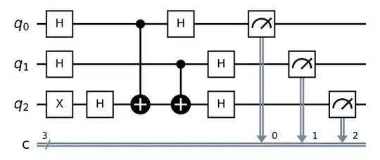

Thus, when designing a quantum algorithm, we want the final state which contains the answer we are looking for be in a single eigenstate and not in superposition with respect to the computational basis (Z basis). For instance, the following circuit will create a state that is NOT in superposition in the computational basis...
so if you run the above circuit on a quantum computer, you will only need to measure it ONCE to obtain your result... This circuit is constructed to solve the problem of "secret bitstring". In fact, the state upon measurement is the state $|111\rangle$, which tells you that the secret bitstring is 11... This is known as the Bernstein–Vazirani algorithm. I would recommend you to read up on it as it will help you to understand where the advantage of quantum computation come about.
