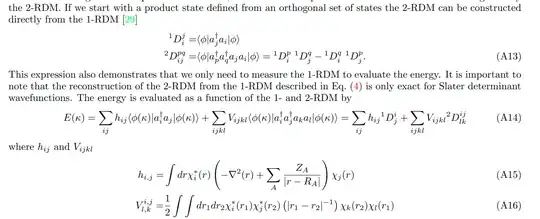

Also, can somebody show me how to calculate energy with 1-electron and 2-electron reduced density matrix with OpenFermion using the following formula (A14).
