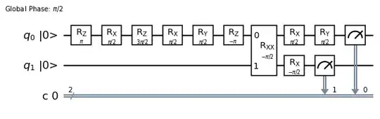

I believe that you can do this actually can be done with Qiskit as well. You just need to specify the basis gates sets you want to use under the transpile function.
For example: If I have the following circuit
which can be generated with Qiskit as:
from qiskit import QuantumRegister, ClassicalRegister, QuantumCircuit
from numpy import pi
qreg_q = QuantumRegister(2, 'q') creg_c = ClassicalRegister(2, 'c') circuit = QuantumCircuit(qreg_q, creg_c)
circuit.h(qreg_q[0]) circuit.x(qreg_q[1]) circuit.cx(qreg_q[0], qreg_q[1]) circuit.measure(qreg_q[0], creg_c[0]) circuit.measure(qreg_q[1], creg_c[1]) circuit.draw( 'mpl',style={'name': 'bw'}, plot_barriers= True, initial_state = True, scale = 1)
Now, if I am targeting a Trapped-ion system then instead of using CNOT as part of the native gate, we use Mølmer–Sørensen gate but this gate is equivalent to $R_{XX}$ gate when using two qubits. So I can transpile my circuit using this $R_{XX}$ gate and single qubit rotation as my native gates. We can do that as follow:
from qiskit import QuantumCircuit, transpile
trans_qc = transpile(circuit, backend = None, basis_gates = ['rx', 'ry', 'rz', 'rxx'])
the transpiled circuit, tans_qc, is now have the form:

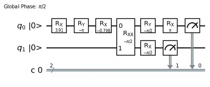

Furthermore, if you want to actually simulate this on a trapped-ion hardware and potentially running on one then I would suggest you to sign-up for a free account with AQT (Alpine Quantum Technologies). Now you can actually set your backend using AQT system and transpile your circuit based on that.
from qiskit_aqt_provider import AQTProvider
aqt = AQTProvider('***********************')
AQT_backend = aqt.backends.aqt_qasm_simulator
trans_qc = transpile(circuit, backend = AQT_backend, optimization_level = 3) trans_qc.draw( 'mpl',style={'name': 'bw'}, plot_barriers= True, initial_state = True, scale = 1)
Which will output:
Use this documentation here for more details.
