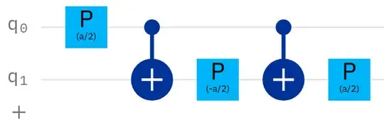

Controlled-$P$ version for any $P$ phase gate. Note that as is mentioned in the previous answer $P(\pi/2) = S$, $P(\pi/4) = T$ and $P^\dagger (a) = P(-a)$. The circuit for controlled-$P(a)$ looks like this
where q[0] is the control qubit. The proof:
$$ I P(a/2) \big[|0\rangle \langle 0|I + |1\rangle \langle 1| X \big] I P(-a/2) \big[|0\rangle \langle 0|I + |1\rangle \langle 1| X \big] P(a/2) I = \\ ={|0\rangle \langle 0|I + |1\rangle \langle 1| e^{a/2} P(a/2) X P(-a/2) X} = \\ = |0\rangle \langle 0|I + |1\rangle \langle 1| P(a) = \text{cotrolled-}P(a) $$
where I have omitted the $\otimes$ sign (e.g. $I P = I \otimes P$).
Like was mentioned in the previous answer one can add control to the $P$ gate in IBM QE circuit composer without using the decomposition of controlled-$P$ shown here.
