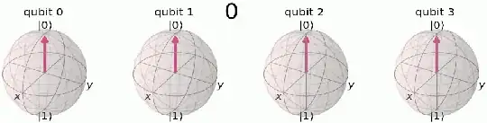

In the computational basis, integers are represented in binary form (with the MSB on the left by convention). So for four qubits $$\vert 0 \rangle=\vert 0000 \rangle, \;\;\vert 1 \rangle=\vert 0001 \rangle, \;\; \vert 2 \rangle=\vert 0010 \rangle,\;\; ..., \;\; \vert 15 \rangle =\vert 1111 \rangle.$$ Algebraically this is given by $$\vert n \rangle=\vert a(2^3)+b(2^2)+c(2^1)+d(2^0) \rangle=\vert abcd \rangle, \;\; a,b,c,d \in \lbrace 0,1 \rbrace, \; n \in \lbrace 0,...,15\rbrace.$$ On the four Bloch spheres associated with $\vert abcd \rangle$, counting from $\vert 0 \rangle$ to $\vert 15 \rangle$ looks like: Computational Basis Counting (Image Source, with $\vert d \rangle=\text{qubit 0}$, $\vert c \rangle=\text{qubit 1}$, ...)
You can see that in the Bloch spheres representation, distinct values of $\vert n \rangle$ are distinguished by ordered sets of qubits at either their north pole, $\vert 0 \rangle$, or their south pole, $\vert 1 \rangle$. Intuitively, while counting, the qubit associated with the LSB, $\vert d \rangle$, changes state every step, whereas the qubit associated with the MSB, $\vert a \rangle$, changes state every eighth step. [Note that the Bloch sphere is actually a Riemann sphere (i.e. the complex projective line), so orthogonal states, such as $\vert 0 \rangle$ and $\vert 1 \rangle$, are represented by antipodal points.]

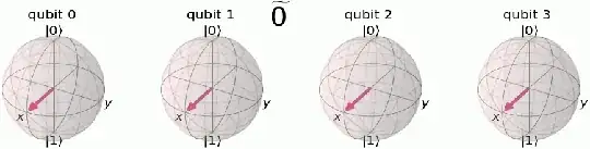

The same 16 integers represented over the Fourier basis, $ \text{QFT} \vert n \rangle = \vert \tilde n \rangle =\vert \tilde a \tilde b \tilde c \tilde d \rangle $, is given algebraically by $$\vert \tilde n \rangle = \tfrac{1}{\sqrt{2^4}}(\vert 0 \rangle + e^{2\pi in/2} \vert 1 \rangle) \otimes (\vert 0 \rangle + e^{2\pi in/2^2} \vert 1 \rangle) \otimes (\vert 0 \rangle + e^{2\pi in/2^3} \vert 1 \rangle) \otimes (\vert 0 \rangle + e^{2\pi in/2^4} \vert 1 \rangle).$$ Now as we count in the Fourier basis from $\vert \tilde n \rangle = \vert \tilde a \tilde b \tilde c \tilde d \rangle = \vert \tilde 0 \rangle$ to $\vert \tilde {15} \rangle$ all four qubits change state every step, with $\vert \tilde a \rangle$ taking the largest steps (i.e. swapping between $\vert + \rangle$ and $\vert - \rangle$, which is $\frac{1}{2}$ of a turn per step) and $\vert \tilde d \rangle$ taking the smallest steps ($\frac{1}{16}$ of a turn per step).
On the four Bloch spheres associated with $\vert \tilde a \tilde b \tilde c \tilde d \rangle$, counting in the Fourier basis appears as each qubit state rotating in the equatorial plane with decreasing frequency from $\vert \tilde a \rangle$ to $\vert \tilde d \rangle$.
Fourier Basis Counting (Image Source, with $\vert \tilde d \rangle=\text{qubit 0}$, $\vert \tilde c \rangle=\text{qubit 1}$, ..., $\vert + \rangle = x$)
In a single counting sequence from $\vert \tilde 0 \rangle$ to $\vert \tilde {16} = \tilde 0 \, (\text{mod} \, \tilde {16}) \rangle$ the qubits associated with $\vert \tilde a \rangle, \, \vert \tilde b \rangle, \, \vert \tilde c \rangle$, and $\vert \tilde d \rangle$ make exactly $2^3, \, 2^2, \, 2^1$, and $2^0$ full rotations in their respective equatorial planes. Similarly, if we consider "no rotation" in the equatorial plane as the state $H\vert 0 \rangle=\vert+\rangle$, then $\vert \tilde 0 \rangle = \vert ++++ \rangle$ gives all qubits unrotated, while $\vert \tilde {15} \rangle$ gives all qubits at their maximal rotation (in the positive direction). [Note that the single qubit QFT is just the Hadamard gate, $H$. In turn, $H$ is simply the 2-level DFT as noted in this previous answer.]
In this example you can see how the high magnitude associated with $\vert a \rangle$ as a constituent of $\vert n \rangle$ in the computational basis corresponds to a high frequency associated with $\vert \tilde a \rangle$ as a constituent of $\vert \tilde n \rangle$ in the Fourier basis, and so forth for $\vert b \rangle \,, \vert c \rangle$, and $\vert d \rangle$. Hopefully this helps to make the analogy between QFT and DFT more tangible.
