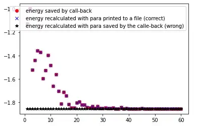

In case someone sees this, and would like to have a workaround, the following code is inspired by the answer due to @KAJ226. Essentially, instead of saving the parameters into a list, we print them into a file so that we can extract them if needed. I compare the following three energies, the values saved by the call-back, the values recalculated with the parameters printed out to the file, and the values recalculated with the parameters saved by the call-back. It is shown that the first and the second values agree with each other. I attached the figure below.

fig,ax = pylab.subplots() Numval = 60 ax.plot( counts[:Numval] , values[:Numval] , 'ro' , label ='energy output by call-back') ax.plot( counts[:Numval] , values2[:Numval] , 'bx' , label = 'energy recalculated with para print-out (correct)') ax.plot( counts[:Numval] , values3[:Numval] , 'k*' , label = 'energy recalculated with para by the calle-back (wrong)') pylab.legend(loc='upper right')
