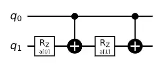

Since $\sigma_z^1 = I \otimes Z$ and $\sigma_z^1 \otimes \sigma_z^2 = Z \otimes Z$ are commute with one another, that is $$ [\sigma_z^1 , \sigma_z^1 \otimes \sigma_z^2 ] = \sigma_z^1 \cdot \sigma_z^1 \otimes \sigma_z^2 - \sigma_z^1 \otimes \sigma_z^2 \cdot \sigma_z^1 = \boldsymbol{0} $$ we have that $$ e^{i\gamma_1 H_a} = e^{i \gamma \frac{1}{2}(\sigma_z^1 + \sigma_z^1 \otimes \sigma_z^2 ) } = e^{i \gamma \frac{1}{2}\sigma_z^1 } e^{i \gamma \frac{1}{2}\sigma_z^1 \otimes \sigma_z^2 } $$ and now note that $e^{i \gamma \frac{1}{2}\sigma_z^1 }$ has circuit construction as: (look here and here page 7 and 8)
and similarly, $ e^{i \gamma \frac{1}{2}\sigma_z^1 \otimes \sigma_z^2 } $ have the circuit construction as:
and put them together, we have the circuit construction for $e^{i \gamma \frac{1}{2}(\sigma_z^1 + \sigma_z^1 \otimes \sigma_z^2 ) }$ as:
