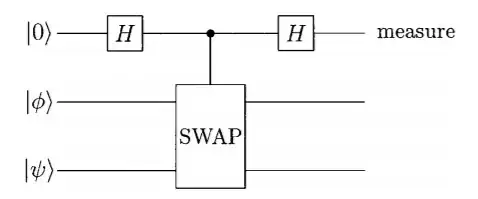

If you are looking for a "more quantum mechanical" approach, then the swap trick best suits you.
The quantum circuit of the swap trick is as follows:
(figure comes from the cited paper.) In this circuit, $|\psi\rangle$ and $|\phi\rangle$ are the two states that you want to compare, then the probability that measuring the uppermost qubit(the control qubit) returns a "0" is $\frac{1}{2}+\frac{1}{2}F(|\psi\rangle,|\phi\rangle)$, where is the fidelity I mentioned in the comment.
Since you know how to get the state vector from qiskit directly, it is more efficient and accurate to calculate the fidelity(or the trace distance) of the two state vectors.
