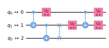

If you want to add the restriction of a particular connectivity map, you can do so with the argument coupling_map. In this case, it is a directed linear connectivity $ 0 \rightarrow 1 \rightarrow 2$:
transpiled = transpile(circuit, coupling_map=[[0,1], [1,2]])
transpiled.draw('mpl')
Notice that a SWAP gate was added and the direction of CNOT was corrected. Also, the qubit allocation is showed on the left-hand side (e.g. logical qubit $q_0$ was allocated to physical qubit $2$.
You can control the qubit allocation with the parameter initial_layout. In the following example, logical $q_0$ is forced to be allocated to physical qubit 0 and so on:
transpiled = transpile(circuit, coupling_map=[[0,1], [1,2]], initial_layout=[0, 1, 2])

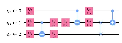

Just to add to the other two good answers, we don't just have qubit layout constraint but also available gates. For instance, SWAP gate or an arbitrary two qubit controlled gate is not being implemented directly as a native gate on current hardware. This is something we should take into account when transpiled the circuit as well.
Fr example, let's us take a similar circuit to the one given by @Luciano:
setting basis_gates= ['u1', 'u2', 'u3', 'cx'] in your transpile call, you might get something like this:
