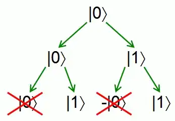

In chapter 9 of Scott Aaronson's book Quantum Computing Since Democritus (see online progenitor lecture notes here), he introduces a strange (to me) conceptualization of applying two Hadamard-like operations to a qbit, summed up in this diagram:
I had the opportunity to ask him about this and he made three interesting statements:
  1. This is called the "Feynman" or "sum-over-paths" picture of quantum mechanics
  2. This picture is interesting because it reveals the effect of destructive interference
  3. If a QC is simulated using the sum-over-paths method, it takes exponential time instead of space

For our example above, this looks as follows; calculating the value of $f(|0\rangle, [U, U], 2)$ (aka the final amplitude for state $|1\rangle$):
$$ f(|0\rangle, [U, U], 2) = U[2,1] f(|0\rangle, [U], 1) + U[2,2] f(|0\rangle, [U], 2) $$ $$ f(|0\rangle, [U, U], 2) = \frac{1}{\sqrt{2}} f(|0\rangle, [U], 1) + \frac{1}{\sqrt{2}} f(|0\rangle, [U], 2) $$ $$ f(|0\rangle, [U, U], 2) = \frac{1}{\sqrt{2}} \left( \frac{1}{\sqrt{2}} f(|0\rangle, [\ ], 1) + \frac{-1}{\sqrt{2}} f(|0\rangle, [\ ], 2) \right) + \frac{1}{\sqrt{2}} f(|0\rangle, [U], 2) $$ $$ f(|0\rangle, [U, U], 2) = \frac{1}{\sqrt{2}} \left( \frac{1}{\sqrt{2}} \cdot 1 + \frac{-1}{\sqrt{2}} \cdot 0 \right) + \frac{1}{\sqrt{2}} f(|0\rangle, [U], 2) $$ $$ f(|0\rangle, [U, U], 2) = \frac{1}{2}+ \frac{1}{\sqrt{2}} \left( \frac{1}{\sqrt{2}} f(|0\rangle, [\ ], 1) + \frac{1}{\sqrt{2}} f(|0\rangle, [\ ], 2) \right) $$ $$ f(|0\rangle, [U, U], 2) = \frac{1}{2}+ \frac{1}{\sqrt{2}} \left( \frac{1}{\sqrt{2}} \cdot 1 + \frac{1}{\sqrt{2}} \cdot 0 \right) $$ $$ f(|0\rangle, [U, U], 2) = 1 $$
Given $m$ unitary operations on $n$ qbits, this will clearly take $O(4^m)$ time if every operation is a two-qbit 4x4 matrix, since it will lead to four additional recursive calls at every level. It will take at least $O(m)$ space, since the recursive call stack will grow to length proportional to $m$ (other sources say $O(m + n)$ but I'm not sure where the $n$ term comes in).
It's somewhat unclear how you could efficiently determine the indices of amplitudes affected by the operator at each recursive level, but I'm sure if I thought about it hard enough there'd be some obvious trick. I'll also have to think some more about how this recursive algorithm relates to the branching diagram up above.
