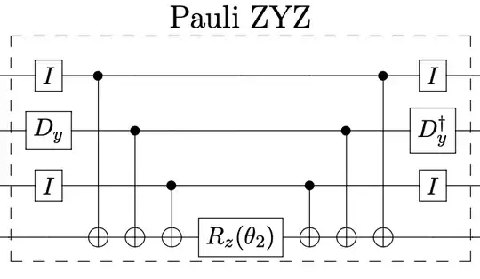

I'm reading a Hamiltonian simulation example proposed in this paper. From their notation, the operator $D_y$ (sometimes it's called $H_y$) serves the function to diagonalize the Pauli matrix $\sigma_y(Y)$ (the corresponding circuit is illustrated below): $$ D_y\ (or\ H_y)=HSX=\frac{1}{\sqrt{2}}\begin{bmatrix} i & 1\\ -i & 1 \end{bmatrix} \quad\quad\quad [A] $$

A and C are technically the same thing, they only differ by a global phase, which makes no difference.
B is technically different, but serves the same purpose. Note that if $UYU^\dagger=Z$, then $$R_zUYU^\dagger R_z^\dagger=R_zZR_z^\dagger=ZR_zR_z^\dagger=Z$$ so if the only effect you're interested in is the diagonalisation of $Y$, there is a freedom of an arbitrary $Z$ rotation $R_z=e^{i\theta Z/2}$ in the definition of your unitary.
In the end, we have the relations $$ D^C=-iD^A=S^\dagger D^B. $$
