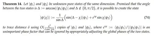

Regarding your original question, the problem you are interested in is known as coherent state addition. You can look up Theorem 14 in my paper to see how it can be achieved, given enough copies of both states.
The main idea is to make one of the states evolve according to the Hamiltonian given by the commutator $i[|\phi\rangle\langle\phi|,|\psi\rangle\langle\psi|]$ of the two states. This can be achieved by repeatedly combining the two states using the swap test (this is reminiscent to what eqb proposed in their answer). The intuition for why this works is similar to Grover's algorithm -- you are trying to implement a rotation in the 2-dimensional subspace spanned by the two states and rotate one of them somewhere in between the two.

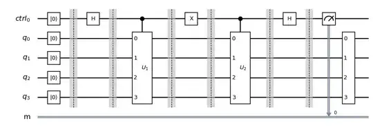

Here's one way to do it. Let's start with some assumptions: here, I'm assuming your circuits $C_1$ and $C_2$ use the same number of qubits. In the drawing, I have used four qubits to illustrate the concept, but that doesn't matter. The answer below does not care about the number of qubits (which I call $n$), just that the two circuits have the same number of qubits.
I also assume that since we have these two circuits $C_1$ and $C_2$, we can create controlled versions of them. This is not hard to do. [edit after @DaftWullie's comment: the question above starts, "Given a quantum circuit..." so I am assuming here that I know what the circuits are. In the general case of completely unknown circuits, this may not be as easy.]
In addition to the number of qubits needed for your circuits, I also need one more qubit to do this work. It's called ctrl$_0$ in the figure.
quantum circuit for generating the superposition state psi1 + psi2 probabilistically
Start with all the qubits reset to the state $\vert0\rangle$. Then, apply a Hadamard gate to ctrl$_0$, and you have the combined state
$$ \frac{1}{\sqrt{2}}\left(\vert0\rangle + \vert1\rangle\right)\otimes \vert0\rangle_n $$ where the ordering is apparent from above.
Next, apply the controlled-$U_1$ box, which really just contains the circuit $C_1$ that you have given me. The combined state is now
$$ \frac{1}{\sqrt{2}}\left(\vert0\rangle\vert0\rangle_n + \vert1\rangle\right\vert\psi_1\rangle_n) $$
After applying the $X$ gate, we have
$$ \frac{1}{\sqrt{2}}\left(\vert1\rangle\vert0\rangle_n + \vert0\rangle\right\vert\psi_1\rangle_n) $$
And so, after applying the controlled-$U_2$ box, which really just contains the circuit $C_2$ that you have given me
$$ \frac{1}{\sqrt{2}}\left(\vert1\rangle\vert\psi_2\rangle_n + \vert0\rangle\right\vert\psi_1\rangle_n) $$
After applying the Hadamard gate again on ctrl$_0$, this becomes
$$ \left[\frac{1}{\sqrt{2}}\vert0\rangle\otimes\frac{1}{\sqrt{2}}\left(\vert\psi_1\rangle_n + \vert\psi_2\rangle_n\right)\right] + \left[\frac{1}{\sqrt{2}}\vert1\rangle\otimes\frac{1}{\sqrt{2}}\left(\vert\psi_1\rangle_n - \vert\psi_2\rangle_n\right)\right] $$
Now, if you measured the qubit ctrl$_0$, you will either get 0 or 1. If you measured 0, then you know that the $n$ qubits are now in the state
$$\frac{1}{\sqrt{2}}\left(\vert\psi_1\rangle_n + \vert\psi_2\rangle_n\right)$$
If you measured 1, then you know that the $n$ qubits are now in the state
$$\frac{1}{\sqrt{2}}\left(\vert\psi_1\rangle_n - \vert\psi_2\rangle_n\right)$$
Each of these two outcomes has a probability of 1/2. That means if you really only want the state
then this circuit will give it to you half the time. The other half the time, you know (because you measured 1) that you need to restart the circuit in hopes of getting the outcome that you'd like. Since the probability is 1/2, sooner or later this ought to happen.
This method is probabilistic, of course, but has the nice benefit of giving you a measurement outcome (0 or 1) that tells you if you've done what you wanted or not.
