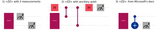

In Microsoft's docs it was proposed (not only) an approach of measuring $\langle ZZ \rangle$ and the question was how one can generalize their approach. Actually the generalization of their approach is not obvious to me and I suggest asking a separate question focused on generalizing their approach. Nevertheless, I want to mention that their approach is not the only way of finding $\langle ZZ \rangle$ and here are three alternative ways for doing it:
  1. If the measured bitstring has odd (even) $1$s then we have measured the state in $-1$ ($+1$) eigenspace. The generalized Qiskit implementation of this approach can be found in this answer. Also, this approach is used (if I have understood the paper right) in this paper from IBM (Fig. 1 shows not only measurements but also simple one qubit unitary transformations ($I$ or $X_{-\frac{\pi}{2}}$ or $Y_{-\frac{\pi}{2}}$) that are specific for each Pauli term).
  2. If we measure the ancillary qubit in $| 0\rangle$ ($|1\rangle$) state then we have measured it in $+1$ ($-1$) eigenspace. This circuit is also used for the Hadamard test / scattering circuit. Note that, Pauli terms have real expectation values, so the described circuit for calculating imaginary part of the expectation value in the Hadamard test is not relevant here. The generalization of this approach is fairly simple: for example, this is the circuit for $\langle XZZY \rangle$.
  3. If measure the target qubit (targeted by CNOT) $|0\rangle$ ($|1\rangle$) then we have measured the state in the $+1$ ($-1$) eigenspace. Although its working, but the generalization of this approach is not obvious for me and I think this question about generalizing the approach shown in Microsoft's docs deserves a separate question.
P.S. There exist also other approaches for calculating $\langle ZZ \rangle$.
