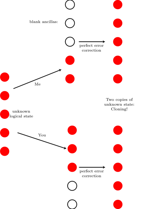

Classical Version
Think about a simple strategy of classical error correction. You've got a single bit that you want to encode, $$ 0\mapsto 00000\qquad 1\mapsto 11111 $$ I've chosen to encode it into 5 bits, but any odd number would do (the more the better). Now, let's assume some bit-flip errors have occurred, so what we have is $$ 01010. $$ Was this originally the encoded 0 or 1? If we assume that the probability of error per bit, $p$, is less than a half, then we expect that fewer than half the bits have errors. So, we look at the number of 0s and the number of 1s. Whichever there's more of is the one that we assume is the one we started with. This is called a majority vote. There's some probability that we're wrong, but the more bits we encoded into, the smaller this probability.
On the other hand, if we know that $p>\frac12$, we can still do the correction. You'd just be implementing a minority vote! The point, however, is that you have to do completely the opposite operation. There's a sharp threshold here that shows, at the very least, that you need to know which regime you're working in.
For fault-tolerance, things get messier: the $01010$ string that you got might not be what the state actually is. It might be something different, still with some errors that you have to correct, but the measurements you've made in reading the bits are also slightly faulty. Crudely, you might imagine this turns the sharp transition into an ambiguous region where you don't really know what to do. Still, if error probabilities are low enough, or high enough, you can correct, you just need to know which is the case.

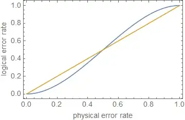

On 1)
Error correction works for large error rates (smaller than $1/2$). Take for example the simple 3 qubit repetition code. The logical error rate is just the probability for the majority vote to be wrong (the orange line is $f(p)=p$ for comparison):
plot physical vs logical error rate
So whenever the physical error rate $p$ is below $1/2$, the logical error rate is smaller than $p$. Note however, that is particularly effective for small $p$, because the code changes the rate from $\mathcal{O}(p)$ to a $\mathcal{O}(p^2)$ behaviour.
