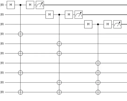

Here is a circuit that can create the desired state (similar ideas were discussed in this answer), if all mentioned measurements yield $|0\rangle$ state:
or in a more compact form (the circuits are constructed via quirk). The first three qubits are ancillary qubits and the rest are the qubits where $|0_L\rangle$ will be created if after the measurements all ancillary qubits are in the $|000\rangle$ state, otherwise one should repeat the procedure until the desired measurement result will be archived.
Let's go step by step. The circuit has three parts and in each step, we assume that the measured state of the ancillary is $|0\rangle$. The normalization factors are omitted.
  1. The state after measuring the first ancillary qubit in the $|0\rangle$ state: (measuring $XIXIXIX$ stabilizer)
$$|000\rangle \big( |0000000\rangle + |1010101\rangle \big)$$
  1. The state after measuring the second ancillary qubit in the $|0\rangle$ state: (measuring $IXXIIXX$ stabilizer)
$$|000\rangle \big( |0000000\rangle + |1010101\rangle + |0110011\rangle + |1100110\rangle\big)$$
  1. The state after measuring the third ancillary qubit in the $|0\rangle$ state: (measuring $IIIXXXX$ stabilizer)
$$|000\rangle |0_L\rangle = |000\rangle \big( |0000000\rangle + |1010101\rangle + |0110011\rangle + |1100110\rangle \\ |0001111\rangle + |1011010\rangle +|0111100\rangle + |1101001\rangle \big)$$
After disregarding the ancillary qubits that are in the $|000\rangle$ state we will have the desired $|0_L\rangle$ state. The probability that each measurement outcome will be $|0\rangle$ is $0.5$, thus the probability of creating the $|0_L\rangle$ state with this circuit is $0.125$. For Qiskit, one can implement the circuit mentioned above, then apply any algorithm or gate that is needed on the $|0_L\rangle$ state, and after the computation disregard all the results where ancillary qubits are not in the $|000\rangle$ state.

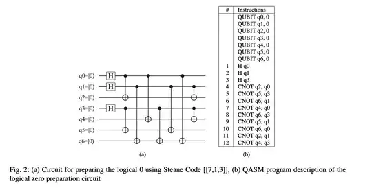

Here's a direct circuit to produce the logical $\bar{|0\rangle}$ state from https://arxiv.org/abs/1501.02524:
I'm not a qiskit expert, but in Cirq, I can check the superposition created by this:
import cirq
q = cirq.LineQubit.range(7) state = cirq.Circuit( cirq.H(q[0]), cirq.H(q[1]), cirq.H(q[3]), cirq.CNOT(q[0], q[2]), cirq.CNOT(q[3], q[5]), cirq.CNOT(q[1], q[6]), cirq.CNOT(q[0], q[4]), cirq.CNOT(q[3], q[6]), cirq.CNOT(q[1], q[5]), cirq.CNOT(q[0], q[6]), cirq.CNOT(q[1], q[2]), cirq.CNOT(q[3], q[4]), ).final_state_vector(0, qubit_order=q) print(cirq.dirac_notation(state))
results in
0.35|0000000⟩ + 0.35|0001111⟩ + 0.35|0110011⟩ + 0.35|0111100⟩ + 0.35|1010101⟩ + 0.35|1011010⟩ + 0.35|1100110⟩ + 0.35|1101001⟩
