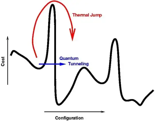

As this is an anneal, the process is done slowly enough to stay near the ground state of the system while the Hamiltonian is varied to that of the problem, using tunnelling to stay near the ground state as described in Nat's answer.

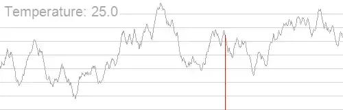

Annealing's more of an analog tactic.
The gist is that you have some weird function that you want to optimize. So, you bounce around it. At first, the "temperature" is very high, such that the selected point can bounce around a lot. Then as the algorithm "cools", the temperature goes down, and the bouncing becomes less aggressive.
Ultimately, it settles down to a local optima which, ideally, is favorably like the global optima.
Here's an animation for simulated annealing (non-quantum):
But, it's pretty much the same concept for quantum annealing:
