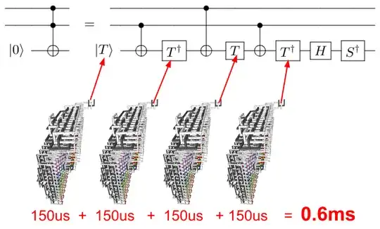

For example, here is an image from some slides I presented last year:
quantum and gate
The things along the bottom are magic state factories. They have a footprint of 150K physical qubits. Since the AND gate uses 150K qubits for 0.6 milliseconds, we surmise that the spacetime volume of a quantum AND gate is on the order of 90 qubit seconds.
One of my coworkers' goals is to use 1 cpu per 100 qubits when performing error correction. So we might say that 90 qubit seconds requires 0.9 cpu seconds of work. We've made the quantum constructions several times more efficient since the above image was made, so let's call it 0.1 cpu seconds instead.
(There are many assumptions that go into these estimates. What kind of architecture, error rates, etc. I'm only trying to convey an order of magnitude idea.)
It takes 63 AND gates to perform a 64 bit addition. 63*0.1 cpu seconds ~= 6 cpu seconds. Quantumly, a 64 bit addition costs more than a CPU second. Classically, a 64 bit addition costs less than a CPU nanosecond. There's easily a constant factor difference of 10 billion here. If you compare against a parallel classical machine, such as a GPU, the numbers get even worse. You can't ignore constant factors with that many digits.
For example, consider Grover's algorithm, which allows us to search for a satisfying input to a function in sqrt(N) evaluations of the function instead of N evaluations. Add in the constant factor of 10 billion, and solve for where the quantum computer starts to require fewer evaluations:
$$\begin{align} N &> 10^{10} \sqrt{N}\\ N &> 10^{20} \end{align}$$
Grover's algorithm can't parallelize the evaluations, and the evaluations require at least one AND gate, so basically you only start seeing CPU time benefits when the search is taking tens of millions of years.
Unless we make the constant factors a lot better, no one is ever going to use Grover search for anything useful. Right now the quantum-vs-classical situation is exponential advantage or bust.
