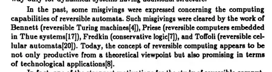

Toffoli's February 1980 tech report MIT/LCS/TM-151 states: enter image description here
Where reference [7] is:
Conservative Logic is then published in 1982 in at least different guises: an article in International Journal of Theoretical Physics and a chapter in Collision-Based Computing.
So the implication to me is that the Fredkin gate precedes the Toffoli Gate.
