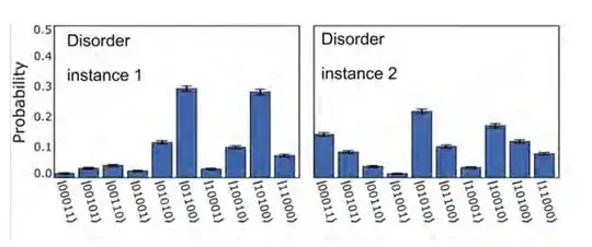

After repeating the measurements on exactly the same circuit (for example, one million times), you can draw a bar chart (see the picture below) and get the distribution function approximately and then compared the distribution to the simulation distribution as it's mentioned in this lecture note.
and in the caption of this picture it's said:
Lastly, we measure the state of every qubit. The measurement is repeated many times in order to estimate the probability of each output state. Here, we plot the measured probabilities for two instances after 10 coupler pulses (cycles).

And the last question is, what does instance mean in the figure above? Is the bar chart of each instance obtained by repeating a large number of measurements on a same circuit with the same value $s$?
