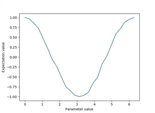

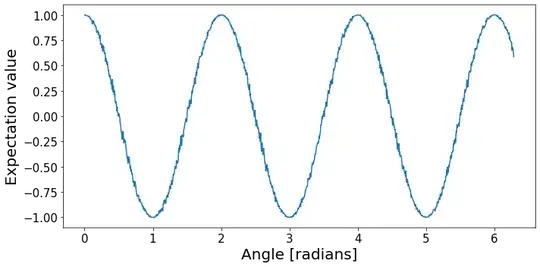

And the plot I get for my expectation values for the ansatz: enter image description here
And here is the tutorial:
Edit: I also implemented this on Qiskit and did obtain the plot to match Grove's.

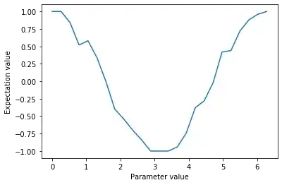

In the tutorial, the RY gate is used. What you are using is different. If you look at the corresponding documentation of that gate, you would see:
Note in particular that this gate has a global phase factor of e^{i·π·t/2} vs the traditionally defined rotation matrices about the Pauli Y axis.
This may explain the difference. You can use instead the cirq.ry operation to reproduce the tutorial.
EDIT
I tried your code by replacing by cirq.ry :
ygate = cirq.ry(parameter_y)
And running the following gave me the correct plot:
params_range = np.linspace(0.0, 2 * np.pi, 25)
data = [expectation_value_vqe(params) for params in params_range]
