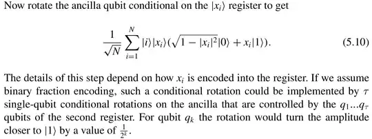

From "Supervised Learning with Quantum Computers" by M. Schuld & F. Petruccione (p. 157):
