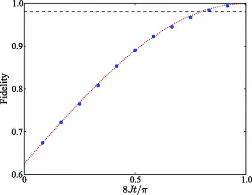

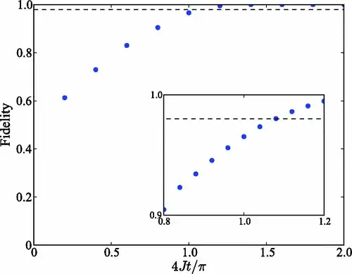

There has been some early studies on the speed limits of speed limits for quantum gates in multi-qubit systems by S. Ashhab, P. C. de Groot, and Franco Nori published in Physical Review. As per this research, it is found that the three-qubit Toffoli gate time varies greatly depending on the type of interactions and the system's geometry, taking only slightly longer than a two-qubit controlled-not (CNOT) gate for a triangle geometry. As per this research, the fidelity of the CNOT and SWAP gates are plotted in the following diagrams.
The fidelity of the CNOT gate as a function of the allowed time (t) in the case of Ising interactions.
The fidelity of the CNOT gate as a function of the allowed time t
The fidelity of the √swap gate as a function of the allowed time (t) in the case of Heisenberg interactions.
The fidelity of the √swap gate for the pulse obtained as a function of the allowed time t
