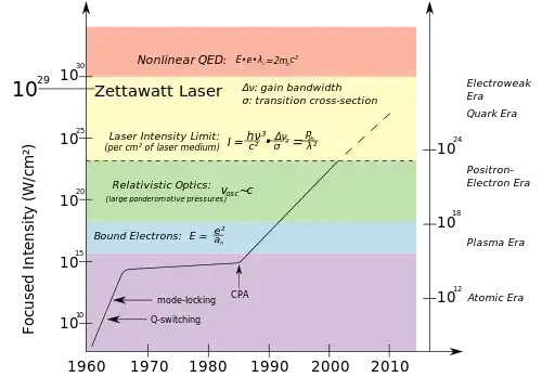

This is bad enough that running your laser at an intensity high enough for self-focusing to matter is a recipe for ruining your laser, and you'll typically get a string of damage as the beam de-focuses at damaged spots and re-focuses down the line. This kind of damage was for a long time the limiting factor in obtaining high peak power lasers,
(Image source)
until the advent of Chirped Pulse Amplification, which allows you to stretch your pulse out in time, amplify it at a safe intensity, and compress it back to a short duration. And of course, after you've compressed it back then any transmissive optics need to be very carefully designed to avoid ruining the whole beamline.
