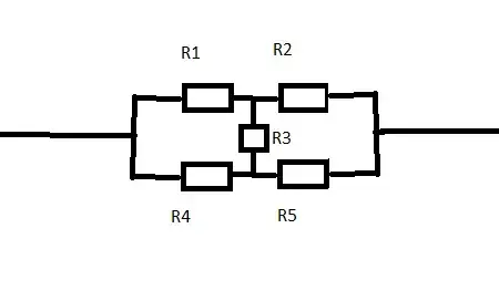

I can't figure out what kind of connection it would be if i put resistors like thisenter image description here
Can someone please explain how they are connected, like is R1 and R2 in series and R4 and R5 in series and then I make a parallel of R12 and R45 and R3?
And what if I replaced R3 with a capacitor would it be connected in parallel with these resistors so I could get the charge on the capacitor by doing $q = C * U$
