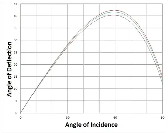

1) Light from the sun strikes a spherical raindrop across half of its entire surface. So every angle of incidence A from 0 to 90 is represented.
2) Some of the light will reflect (uninteresting), but some will enter the drop. Its path bends due to refraction, entering the drop at an angle B (found by Snell's Law) that is always less than A. This means that it is always less than the "critical angle" C that corresponds to A=90°.
3A) The light strikes the back of the raindrop at the same angle B. Some of it will exit the drop, bending again. The reverse of Snell's Law applies, so that it exits at angle A.
3B)... and some will reflect. Many explanations will incorrectly say that Total Internal Reflection occurs. That can only happen if the angle at the back is greater than C, which is impossible.
4) The light that reflects repeats this process every time it encounters the surface from the inside. Light that exits after one reflection makes the primary rainbow. The total deflection angle D, relative to your own shadow, depends on A and the color of the light, and looks like this: enter image description here
5) Look at just the red line. It has a maximum around A=60° and D=42°. But the range of A's that produce angles that are close to 42° is much greater than the range that produce any other angles. As a result, red is much brighter around 42° than anywhere else. There is dimmer red inside of 42°, but no red light outside of 42°. If the sun had only red light (as it does near sunset, see http://d3819ii77zvwic.cloudfront.net/wp-content/uploads/2014/06/main11.jpg), you would see a filled-in, red circle with a very bright rim.
6) Each successive color in ROYGBIV has a similar, but smaller, circle. As a result, the bright rims are situated at different places resulting in the colored bands you see.
