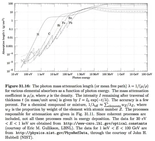

Compton Scattering seems to offer a candidate solution; i.e. that it's the scattered, lower frequency waves that make it through. However, according to this article, and more specifically this graphic (shown below), Compton Scattering starts occurring at a certain energy threshold, so it doesn't explain the relatively high penetration depth of lower frequencies. Furthermore, the graph also demonstrates that the penetration depth is proportional to the photon's energy, which again contradicts the trend discussed in the first paragraph, where one would expect the penetration depth to decrease as the photon's energy increases.
Attenuation length vs. Photon energy
I have looked for an answer on several sites, but none have provided me with a fully satisfying answer. These sites tend to either simplify the material, or simply gloss over this particular aspect of the more general question: "Why are materials transparent?". So, to summarize, my question is:
Why does the penetration depth of high frequency waves increase for higher energies, and why is this not (apparently) applicable to lower frequencies? Given a high enough frequency, but still lower than the Compton Scattering frequency, why aren't all surface atoms ionized, effectively making the material opaque? (i.e. photoelectric absorption)

All photon absorptions happen "on the surface" of a material. However the depth of "the surface" depends on the cross sections for the photon absorption processes involved. For visible and UV photons these cross sections depend on the atomic structures and molecular structures and crystal structures in quite complicated ways. For low-energy x-rays, you may have photon wavelengths comparable to the angstrom-scale spacing between atoms, which permits coherent scattering and diffraction. Once the wavelength of the light becomes smaller that the spacing between atoms, the photon essentially interacts with each atom separately, and the probability that a photon travels a distance $\ell$ without scattering is given by $\exp(-n\ell\sigma)$, where $n$ is the number density of scatterers and $\sigma$ is the cross section.
For very high-energy photons, the mean free path between collisions in matter does in fact level off. You just needed a bigger figure:
photon mean free path in matter
(This image is from the Particle Data Group.)
  • For sub-MeV photons the dominant contribution to photon scattering is electronic transitions in the atoms. As the photons become energetic enough to knock out electrons from the next shell down, the mean free path suddenly decreases, which gives the curves their "spiky" shape (also present in your example).
  • For MeV-scale photons the dominant effect is Compton scattering, and so the most important parameter in the mean free path is the number of electrons that the photon passes. This is why all the curves except H come together around 2 MeV: most materials have roughly one electron for every two nucleons, except hydrogen which has roughly one electron for every nucleon.
  • For higher-energy photons the dominant scattering process is electron-positron pair creation, which occurs when the high-energy photon scatters off of "virtual photons" in the electric field between the atomic electrons and their nucleus. The internal electric field is stronger for heavier nuclei, so a kilogram of heavy nuclei will stop more high-energy photons than a kilogram of lighter nuclei.
Note that while the mean free path between photon-material interactions levels off for photons somewhere above 100 MeV, the amount of material that's required to "stop" the photon continues to grow, more or less without any upper bound. This is because the photon doesn't stop at its first interaction, but divides its momentum among the electron-positron pairs, scattered electrons, and lower-energy photons that it creates. This "shower" of electromagnetic leftovers propagates forward in a cone, and can penetrate quite a bit of material.
