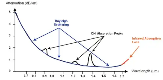

So what is the underlying physics for all this. I fetched the drawing below from the JDSU product literature:
Gregory Lietaert, "Fiber Water Peak Characterisation"
and this illustrates much of what I want to say:
Optical Fibre Loss
Two things limit signal transmission through optical fibres- attenuation and dispersion. A great deal of technology has been developed to deal with the latter, dispersion, which limits bandwidth through scrambling signal transmissions through variable group delay. Dispersion is almost wholly a linear effect, so its effects can be almost totally annulled and compensated for by devices such as optical fibre gratings (see also Long Period Gratings and also dispersion shifted fibre. Loss is a much bigger problem and can only be overcome by regeneration through fibre amplifiers; loss limits transmission rates through noise: even in a perfectly clean system where amplifiers had zero noise figure, the optical quantum limit prevails and sets the limit: see my detailed discussion in my answer to the Physics SE question Maximum theoretical bandwidth of fibre-optics.
So, given these comments, it is obvious that for fibres of many kilometres length, we need to work in wavelength bands where the attenuation is less than 1dB each kilometre. Thus, from the diagram above, the reason for the 1300nm and 1550nm bands is obvious. The 1550nm band is the lower loss band but historically the 1300nm band was used first because this is where the zero dispersion wavelength of a simple step refractive index silica fibre tends to sit. Before dispersion cancelling technology such as dispersion shifting fibre refractive index profiles and and fibre gratings were fully refined, residual dispersion tended to be the ultimate limit. As this was tamed, the practicable lengths of fibres became longer, so the 1550nm band was gradually used. Moreover, the erbium doped fibre amplifier technology came into being to realise regeneration stations in fibre networks, and this works at 1550nm. But nowadays the bandwidths asked of fibres are so huge that all practicable bands - those between about 1260nm to 1625nm - must be used, with research underway to open up channels in the 850nm band.
