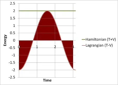

Setting $A = 2$, and $m=k=1$ we can plot the following graph over time:
Hamiltonian vs Lagrangian
In this graph, the highlighted area, the area under the curve plotted by the lagrangian, is the action. The area under the curve depends on the interval of interest (however, for integer multiples of the wave period, and for infinite time, the action would equal zero [see note]). In any case, this should give an intuitive notion for action, and for the concept of a functional...the area under the curve for some interval is a number determined by the integral of a function:
$$S=\int L \;\mathrm{d}t$$
