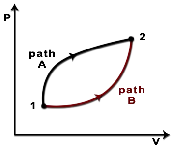

I feel as though I've seen images like this:
enter image description here $$ $$ in which the paths are identified as corresponding to an irreversible and a reversible process respectively. This is consistent with another idea: I've often heard it stated that we can write $dW = -p\,dV$ for reversible processes only. This equation I have always found somewhat perplexing, since the left hand side is seemingly an inexact differential, whilst the right hand side seemingly exact! Is the resolution of this that the condition of reversibility restricts us only to certain paths for which the integral of $dW$ is indeed path-independent? Or perhaps $p\,dV$ is not an exact differential, since the variable $p$ is not solely a function of $V$? By this I mean: if $p = p(V,X)$ (where $X$ is just some other variable), then the integral of $p\,dV$ between two points would indeed depend on the path through $(V,X)$ space taken.

Many processes cannot be drawn on a p-V diagram because the pressure is not always defined.
Those processes that can be drawn are called "quasi-static". However, you cannot look at a certain path and say whether it represents a reversible or irreversible process for sure.
For example, imagine a vertical line on the p-V plot, corresponding to adding heat to a system of fixed volume. You can do this reversibly by only allowing the heat source temperature to be infinitesimally different from your system's temperature at any time, or you can do it irreversibly by keeping your heat source at a finite temperature difference from your system, but only allowing the heat to enter very slowly, so that the system achieves equilibrium and the pressure is well-defined.
The path the process takes is the same in both cases, but one process is reversible and the other is not.

For a single variable external work function where $p_{ext}$ is the external (control) pressure and $V_{ext}$ is external (control) volume the infinitesimal work performed is always $\delta W=−p_{ext} dV_{ext} $ irrespective of whether the process is reversible or irreversible, and at any speed. This is pure mechanics but if it is not reversible work then one cannot say that $\delta W = - p_{sys} dV_{sys} $ While it usually true that $dV_{ext} = dV_{int}$ if there is, for example, friction then $p_{ext} \neq p_{int}$. With reversibility the external control parameters are the ones that also describe the state of the system under control at any given instant, and that the relationship among the various intensive and extensive internal system parameters are time independent simple multivariable functions without any time derivatives (rates) being involved.
Reversibility and quasi-static are not the same. There are systems that in the words of Bridgman are completely surrounded by irreversibility independently of the speed of the process. A well-known example is a ferromagnet that upon executing a BH cycle dissipates the area enclosed in the hysteretic curve even if the process is infinitely slow. Friction is another example and so is plastic deformation.
Note also that in general $\delta W$ is not an exact differential unless you restrict the process. One example is an adiabatic process (can be either reversible or irreversible), that is one for which $\delta Q = 0$. This is because the internal energy $U$ is always a state function and with energy conservation $dU = \delta W + \delta Q $ so for an adiabatic process $dU = \delta W$, an exact differential. Another case is when you assume an isothermal and reversible process then from $\delta Q = TdS$ you get that $dU-\delta Q = d(U-TS) = \delta W$ again an exact differential.
