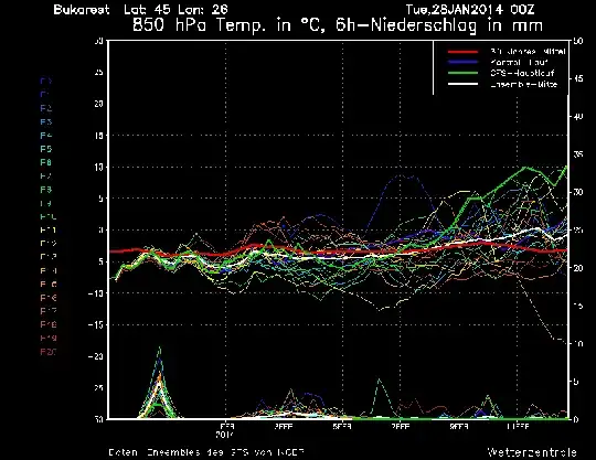

Therefore, models are typically run a number of times, for example, ten runs. Where the runs coincide, the forecast is rather certain. Where they diverge, the forecast is not. Below is an example of such for Bucharest, Romania, run on 28 January 2014:
Ensemble forecast for Bucharest
As you can see, the 850 hPa temperature agrees fairly well the first couple of days, but by the end, they are “all over the place”. This kind of plot, which may also be on a map, is also referred to as a spaghetti plot. Although they are not difficult to understand, they do tend to focus on “expert” variables and do not directly translate to precipitation amounts or sunshine hours. They are direct model output.

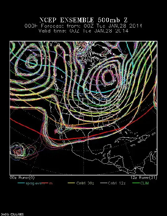

Below is an example of an NCEP run for the US and surroundings. At 0 hours, all the model runs agree fairly well (fortunately):
NCEP ensemble 0h

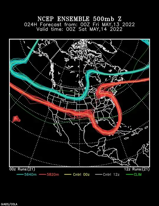

After 24 hours, the picture still looks fine:
NCEP ensemble 24h

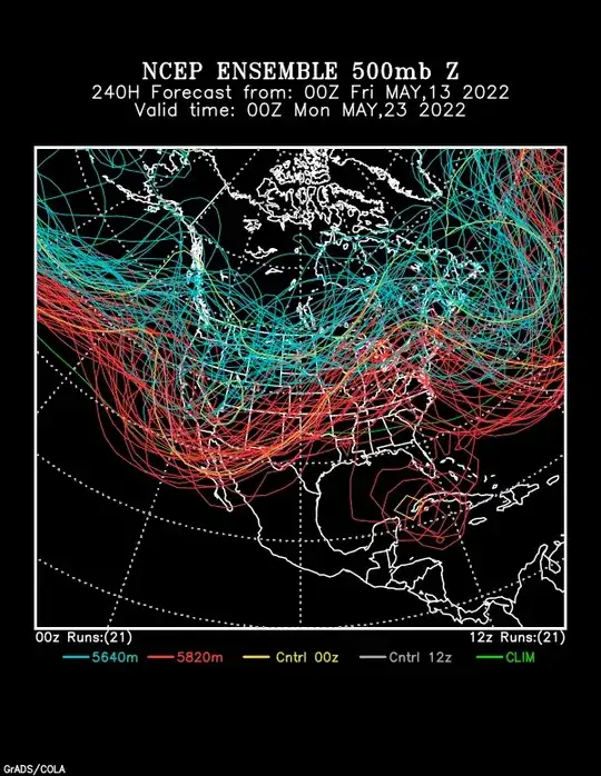

At 240 hours, however, it's pretty much spaghetti. This means the forecast that weather.com gives you is pretty much useless:
NCEP ensemble 240h
