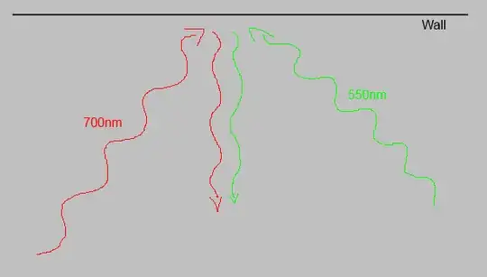

Let's say I light a wall with two spotlights: One red and one green one. Where they overlap, I'll see a yellow area at the wall.
My question is, whether this is caused by an modification of the frequency/wavelength or simply by my eye combining the two incoming lights.
Light is "added", wavelength is modified: enter image description here
The eye combines two separate lights: enter image description here
Short answer No So your second picture is accurate. Frequency is not modified, the two different waves are added up by your eye to produce the light that you perceive.
