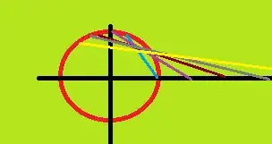

The first apparent indication that this makes any sense is the claim that the summation machine 'really' works in the complex plane, so that, for a sum like $1 + 2 + 4 + 8 + ... = -1$ there is some process like this:
going on on a unit circle in the complex plane, where those lines will go all the way back to $-1$ explaining why it gives that sum.
The claim seems to be that when we have a divergent series it is a non-convergent way of representing a function, thus we just need to change the way we express it, e.g. in the way one analytically continues the Gamma function to a larger domain. This claim doesn't make any sense out of the picture above, & I don't see (or can't find or think of) any justification for believing it.
