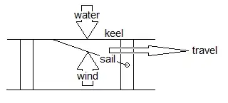

AND yet another explanation, seeking a super-simple intuitive image of what's going on. Here's a catamaran on a broad reach:
What makes it go is the squeezing effect between the water and the wind on the triangle consisting of the keel and the sail. There is no limit on the speed of travel. The narrower the triangle is, the faster it can go, limited only by drag. Also, the direction of travel need not be at right angles to the wind, as long as there are components of the wind's force and the water's force acting to squeeze the wedge.
Now suppose the water surface is actually a cylinder oriented downwind, and the boat sails around and around it. Then the sail looks more like a fan blade (like on the blackbird car) but it works the same.

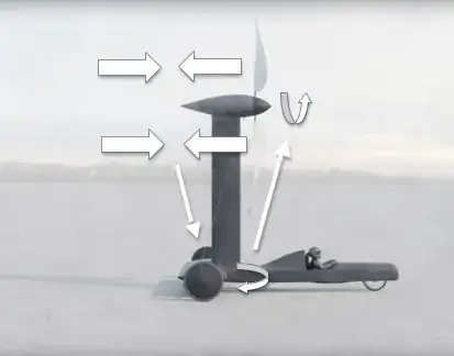

Here is the simplest explanation I can think of.
Indeed the propeller doesn't work like a windmill powering the wheels, but like a fan powered by the wheels.
What the diagram shows:
  • The wind and the fan collaborate to push the car forward. When at rest, the wind alone pushes the car. But as soon as the propeller turns, it adds to the push.
  • Pushing the car makes the wheel turn.
  • Turning the wheels powers the propeller, helping to push the car.
The thing to understand is that the action of the wind and the propeller both contribute to create the push on the car. The wind moves the air forward making it easier for the propeller to move the car. Therefore the push on the car provides more energy to the wheels than the energy required by the propeller to do its part.
If there were no wind, assuming 100% efficiency, the energy required to push the car would indeed equal the energy that can be captured from the wheels. That would be a perpetuum mobile. But since the wind provides part of the energy that pushes the car, you need less energy from the propeller.
In summary:
  • The wind and the propeller both provide power to push the car.
  • The power pushing the car is captured by the wheels and in turn powers the propeller.
  • The power reaching the propeller, even with friction and losses, is enough to power the propeller.
The effect represented by the wind arrows actually happens at the surface of the propeller blades. The propeller pushes back against the air which is already moving forward because of the wind. Imagine these 2 arrows like a spring that is compressed by both sides and results in a force on the propeller.
Credits: The image is from a video by Veritasium.
https://www.youtube.com/watch?v=yCsgoLc_fzI.
The arrows were added by me.
