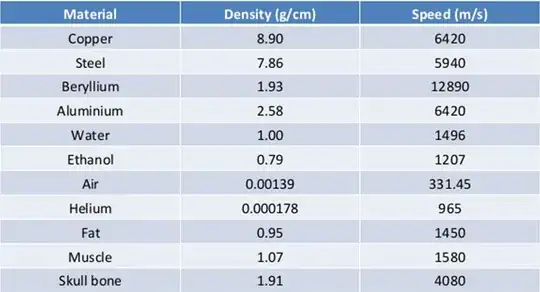

enter image description hereThe speed of sound depends on the medium in which it travels. In air it can be affected by ambient temp, relative humidity , as well as atmospheric pressure. The speed usual quoted at a standard temp and pressure.
http://byjus.com/physics/speed-of-sound-propagation/
