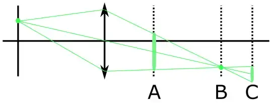

If your system is a single lens you may think of light as a cone:
If your image is forming in B and you put there a screen, a film, a sensor... you get your point-point mapping. If you put it in A or C you get a point-disk mapping, giving overlapping disks when your object have more than one point... These disks are usually gaussian or Airy-like, due to diffraction. As you point with the pinhole limit, finite aperture (not collecting the $2\pi \text{ srad}$ of light but a cone) is the key. If now we reduce the aperture with a diaphragm:

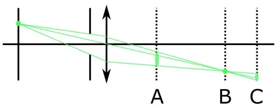

as we do in photography to enlarge Depth of Field, i.e., get every plane "focused", or get a picture focused wherever the plate is, as in the pinhole camera. In this limit, you can also understand how the lens does not matter at all, as it is locally flat in its center. We usually work in terms of transfer functions of black boxes to connect object and screen planes.
