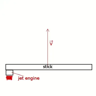

Rocket engine, perpendicular to the end of stick, located in cosmos, without atmosphere and gravitation. As in picture below: enter image description here
In what direction will the stick move? In V or another direction?

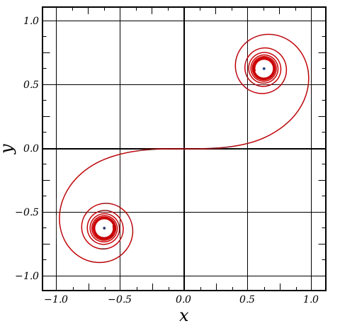

The integrals for velocities are called Fresnel Integrals. They are mostly used in optics. The intriguing result is that a plot of the velocity as a function of time is the Cornu Spiral or Euler Spiral.
The picture is copied from Wikipedia. It's a little bit backwards because $x$ is usually taken to be the integral of $\cos t^2$, whereas we've taken it as the integral of $\sin t^2$. If you imagine rotating the picture 90 degrees clockwise, then mirror-flipping left and right, you get something that matches up with the original drawing.
The left half of the (transformed) picture shows the velocity integrating backwards into the past. The right half shows it integrating into the future. The velocity is asymptotic to
$$v_x = v_y = \frac{\sqrt{\pi/2}}{2} \approx .627$$
The obvious answer is: "In a different direction." Or, more correctly, the direction of vector V will change continuously."
The engine will force the stick to rotate, continuously gaining angular velocity. In addition, assuming the stick begins at rest, there will be a linear component to the AVERAGE OVERALL velocity of the center of mass of the contraption. But it will not be in the direction of vector 'V' as you have it drawn. Somewhere slightly clockwise of 'V' for most reasonable choices of (impulse/mass) and (impulse/rotational_inertia)
Assuming duration of thrust is long enough, vector 'V' will eventually point in EVERY direction in the 2-D plane of the page in which it is drawn, multiple times. Any more significant detail than that requires more information on the mass, center of mass, moment of internia, initial angular velocity, thrust magnitude, and thrust duration.
