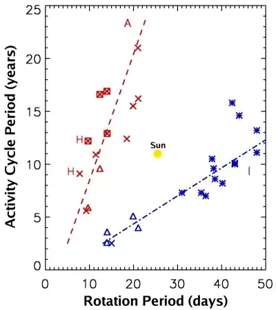

Activity cycle versus rotation period for a sample of stars.  Note that the Sun seems to lie between two fairly distinct sequences (marked A and I).
You're right about the variation of radius against metallicity but the properties of the surface convection zone would probably also change, possibly affecting the dynamo.
