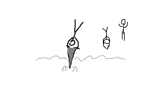

  2. Assume you jump head first and hold a sharp and strong long object that cuts the water before you arrive, will that make the entrance to the water more smooth and protect you?enter image description here

In a free fall you can reach a speed of 50 m/s. Hitting a water surface with that speed is lethal as the statistics from the other answers show nicely. In clive diving competitions they use a trick though to reduce the probability of getting hurt quite a bit. Instead of a flat water surface the athletes jump into basically a bubble bath. With either water or air pumps lots of bubbles are created below the surface and that dampens the fall quite a bit.
The cone would work in a similar way. Under ideal conditions, i.e. hitting the water with the cone exactly at the right angle you could soften the fall so that even a free fall would be survivable.
