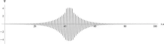

But this model has a problem: its evanescent waves are envelope waves, i.e. in the limit of lattice constant $a\to0$ the waves won't have smooth waveform. To have a smooth waveform for evanescent waves one'd need a band gap between zero frequency and bottom-most band. But as I add smaller and smaller eigenfrequencies in the first band for inner lattice (so that they were smaller then smallest eigenfrequency of outer one), I only get linear waveforms in outer lattice - they never curve enough to become exponential, i.e. the wavevector never becomes imaginary.
I begin to think that at least in purely mechanical case evanescent waves must be envelope waves, and there's no way to make a true (non-envelope) wave with imaginary wave vector.

Here's what I mean by wave with oscillating structure - it is not what I'm looking for: enter image description here
