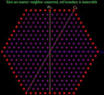

Happy holidays, everyone! The following is part question, part visual gallery, and part classical mechanics problem. Inspired by snow over the weekend I began simulating the vibrations of the following hexagonal lattice system:
The 271 purple dots represent point masses of mass $m=1$ and are spaced apart by a spacing $a=1$, and each point mass is connected to each of its six nearest neighbors via springs with rest length $L=1$ and spring constant $k$. The red dots are fixed in place, and essentially act as an immovable boundary condition, while the purple dots are free to move horizontally and vertically in the plane. The lattice has $D_{6}$ symmetry, and three of the elements (vertical reflection $\sigma_v$, horizontal reflection $\sigma_h$, and $\pi/3$ rotation $C_6$) are shown for reference.

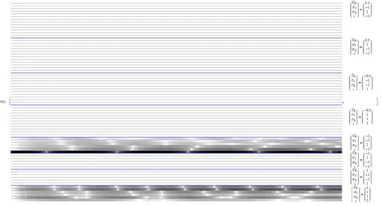

For example, starting in one of the $(C_6,\sigma_v,\sigma_h,i)=(-1,-1,1,-1)$ symmetry states with an amplitude such that the points traveled a distance of about 1/8 (ie, smaller than lattice displacement, but still reasonably large) yielded the following:

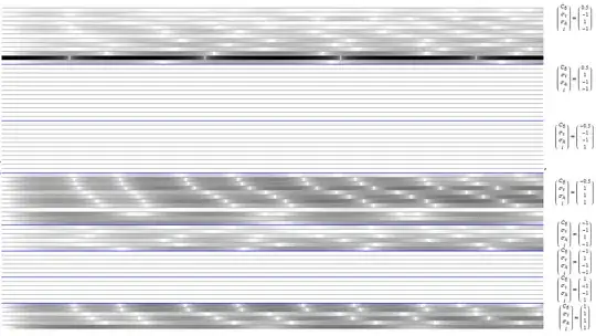

The $x$-axis is time (from left to right), and each of the 74 horizontal bars represents an eigenmode, which have been grouped together by which of the 8 symmetries it belongs to. White indicates no amplitude, black indicates large amplitude, and the color scale is somewhat logarithmic to make things easier to see. As can be seen, near the very beginning amplitude gets mixed into other states, but the mixing is confined to states with $(-1,-1,1,-1)$ symmetry or $(1,1,1,1)$ symmetry only. Similarly, repeating this with a $(\frac{1}{2},-1,1,-1)$ symmetry state yielded the following:

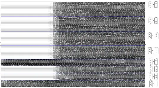

This time, the coupling is limited to four symmetry classes. I found that coupling only depended on symmetry, which I'm sure people more knowledgeable than myself will know well. Finally, I noted that such symmetry restrictions would spontaneously lift themselves at extremely large displacements without warning after some time; the time at which the sudden change occurred was strongly dependent on the precision of the numerical solver, and random noise added to the initial conditions caused an immediate breaking of symmetry. Here is an example of such a phenomenon:
Here's a question: is this an classical-mechanical example of spontaneous symmetry breaking? It seems that the system starts out in a state of definite symmetry, but that upon provocation by numerical noise, population 'tips over the edge' and spills into the rest of the symmetry classes, equalizing everything.

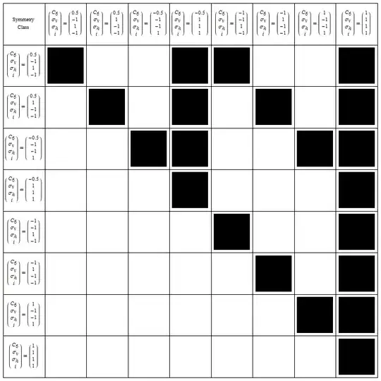

Here's another question. I found that coupling was nonreciprocal, in the sense that population from $(1,-1,-1,1)$ modes could spill into modes of $(1,1,1,1)$ symmetry, but that the reverse was not possible (ie, the flow of amplitude seems to have sources and sinks). To be more specific, the coupling directions looked like this:
If the $i,j$ entry is black, then energy can couple from symmetry class $i$ to symmetry class $j$, and if it's white, it's forbidden (with the exception of when spontaneous breaks occur at extreme amplitudes). Note that not only is it upper triangular with the way I ordered the symmetry blocks here, but it's actually a $2\times 2$ block matrix of the form $$\left(\begin{array}{cc} A & A\\ 0 & A \end{array}\right)$$ where $A$ is a $4\times 4$ matrix which is also upper-triangular. Does anybody have any idea how or why this happens? I have to admit it's all a bit over my head. I did all of this intending to print out posters as a Christmas present for my parents, but I noticed all this wacky stuff in the process. I suspect it's some kind of weird "classical mechanics selection rule" but I'm not very good at algebra, so the reasons are all opaque to me, and I haven't formally taken classical mechanics.
This is the most important bit of information. What causes the symmetry breaking seems to be nonlinearity introduced by numerical errors. So what you are doing is somewhat similar to the Fermi-Pasta-Ulam-Experiment. The big problem is, that you don't know how exactly the non-linearity looks like, how it acts on the system and how strong it is. You can control it by precision of the numerical solver, which is nice, but you don't know, if it conserves energy or if it is a sink/source of energy. Since you are using linear springs to couple the atoms, this simulation has no non-linearity coming from the model itself, only from the implementation on a computer. So you have 3 options here a) insert a nonlinearity, which you can understand and control very well and see how symmetry breaking arises (it should be constructed so that numerical nonlinearities are negligible compared to your model instability). Or b) you try to remove these numerical errors, which is not easy, but it seems to be possible, see this paper: http://zfn.mpdl.mpg.de/data/Reihe_A/52/ZNA-1997-52a-0585.pdf Lastly option c) means you try to understand your numerical errors. This involves understanding the differences between floating point arithmethic (float, double), and fixed-point arithmetic, how your algorithm approximates and cuts off values, in the case of NDSolve of Mathematica, this might be well documented but with a lot of special routines, so that handling is easier for the Mathematica user. In this case it is very advisable to write your own implementation.
I believe I have an answer for the second question, namely, why the coupling table takes the upper-triangular form it does.
In particular, the upper-triangular coupling direction table can be more or less generated by the following simple rule: given an initial state with symmetry numbers $\{\lambda_g|g\in D_6\}$, the lattice applies a force of $g$-gerade symmetry in the generalized coordinates if and only if the state is of $g$-gerade symmetry. I proved the backwards direction here, and I'm conjecturing that the forward direction is usually true, although no one has yet answered my question. so I'm not sure.
