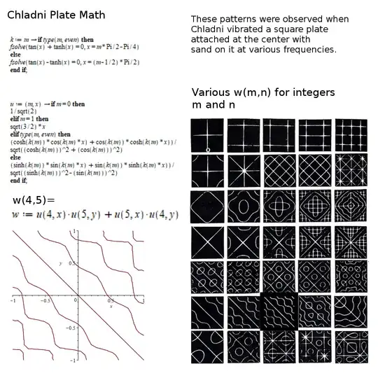

The nice thing about solution of the wave equation by separation of variables is that the solutions you find form a complete set of eigenfunctions for the problem. Furthermore, their eigenvalues tell you the resonant frequency of each particular mode. The image below shows the second, third, and fourth order solutions to your equation (taken from the referenced journal article). When you excite these modes with the sand on the plate, the sand is bounced away from the high points and stays at the un-moving points which are called nodal lines. These nodal lines are the places where the solution is still zero in the diagram below.
Some Eigenmodes from S.V. Bosakov. "Eigenfrequencies and modified eigenmodes of a rectangular plate with free edges" Journal of Applied Mathematics and Mechanics, Volume 73, Issue 6, 2009, Pages 688–691
The Ritz paper is pretty in depth but the simple take away is this formula for integers m and n plotted where it implicitly equals 0. Chladni formula from Ritz
