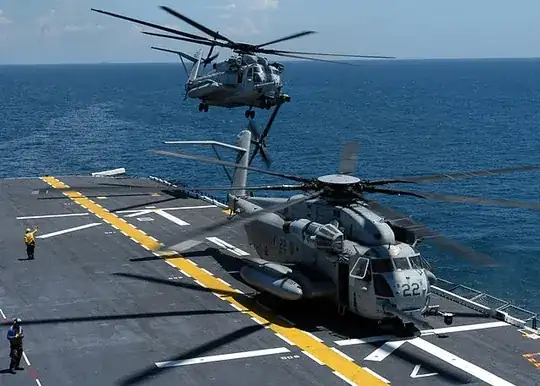

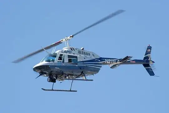

It seems to me that there is a correlation with the weight of the helicopter, for instance the CH-53 has 7 blades while the famous bell 206 just has two. Still comparing it to the case of wind generators, I cannot get an overview of what's going on.
CH-53 bell 206
