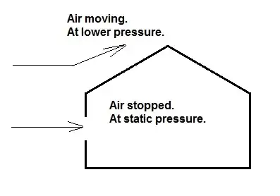

Bernoulli to the rescue!
Does this answer the question?

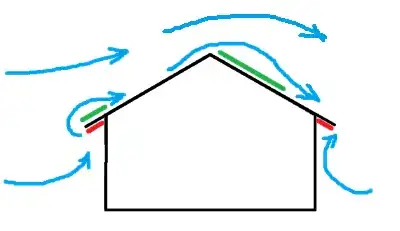

The flow field around the house is complex, with the blue line representing the flow of air, generating high pressure in the red area of the roof and low pressure in the green area. These factors combined will blow away the roof. Moreover, low pressure is not entirely caused by Bernoulli's principle.
