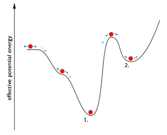

Roughly: Becouse $F=-\overrightarrow\nabla U$, with $U$ some potential energy (coud be an effective potential energy). Then, if you aren't in a minimum of potetial, your system isn't in equilibrium.
Edit: Can you see that 1. and 2. are stables equilibrium?. I chemistry your effective potential energy is some function called Gibbs free energy.

I'll try to explain with the help of an classical example. Take the situations in the picture above. What you're interested in are the first to cases. The unstable state of equilibrium is such a state that when you slightly displace the ball, it departs from the original position. Being at the top of the hill, it has an excess of potential energy (may it be gravitational, electric, etc.) that can be converted into work. However, in stable equilibrium, displacing the ball it will always return to its original position. It was from the start in a state with minimum energy.
