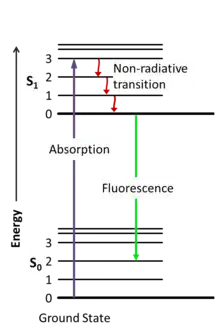

By contrast, fluorescence is exclusively quantum because it requires electrons to be excited into a higher energy state, then lose some of their energy in lattice interactions and settle to a lower level state. The emission is then from electrons dropping from this slightly lower energy state to the ground state. This is why the fluorescence wavelength is always lower than the wavelength of the incident light.

One has a quantum mechanical interpretation for inelastic scattering, that of absorption of the incoming photon and ending up at a high energy level and re emission of photons from de excitation to lower energy levels.
If inelastic scattering happens on a material which does not fluoresce it means that the photon was absorbed and : either the energy goes to vibrational levels or another photon was re-emitted , or more photons cascade down, but the emitted photons are not in the visible range, rather they are in the infrared, finally ending in heat.
On a material that fluoresces, the lifetime is longer and thus the re emission can be observed. In addition each individual atom becomes a source of light and thus the directionality of the incoming beam ( seen in elastic scattering) is lost.
