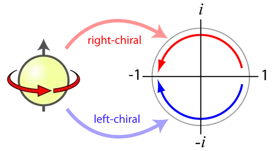

I found the following explanation for chirality for spin 1/2 particles here
What happens when you rotate a left- vs right-chiral fermion 360 degree about its direction of motion. Both particles pick up a -1, but the left-chiral fermion goes one way around the complex plane, while the right-chiral fermion goes the other way. The circle on the right represents the complex phase of the particle's quantum state; as we rotate a particle, the value of the phase moves along the circle. Rotating the particle 360 degrees only brings you halfway around the circle in a direction that depends on the chirality of the fermion.
My question is: Isn't the way the phase of the wavefunction changes related to the direction of rotation of the particle, which is an external parameter depending on how you rotate it? Is there a better explanation for chirality?

Tarek (OP) e-mailed me to contribute to this thread. Here's the response that I gave him (slightly edited for clarity).
I see why this was confusing, my apologies! I was perhaps too glib in the post. Iwas implicitly talking about a chiral rotation but wanted to present it somewhat more intuitively.
Let me try to spell it out more carefully, and hopefully I can also explain why this is the same as what is being explained in QFT textbooks.
The point is the difference between helicity and chirality. Helicity has to do with angular momentum, i.e. spin up or spin down relative to the momentum of the particle. In the massless limit, helicity and chirality are identical. For our purposes, let's treat "chirality" as a label: I have a left-chiral fermion and a right-chiral fermion, just treat these as two different fermions. (This is probably not a great use of the term 'chirality', but hopefully it elucidates the point.)
A left-chiral fermion comes pre-packaged with a left-helicity and a right-helicity state. The anti-particle of a left-helicity, left-chiral fermion is a right-helicity, left-chiral fermion. (Again, you could argue what we mean by chirality here---but for our purposes, it's just a label for this fermion field and is distinct from helicity.)
Suppose I have a left-chiral fermion and a right-chiral fermion. These are two completely different types of fields. With some foresight, let's call the left-chiral fermion an electron and the right-chiral fermion a positron. We will clarify later the connection to the physical electron and positron (its antiparticle), but for now these are just names.

To emphasize once again, "left/right-chiral" is just part of the fermion's name. We could now ask how do #1 and #3 differ, since "chirality" is just some name. Note that this is the relevant comparison, if we want to compare apples-to-apples, then we should compare objects of the same helicity. A left-helicity state is obviously different from a right-helicity state, but how do the two left-helicity states above differ?
In the Ryder formula referenced in the comments to your question, you're comparing the left-helicity and right-helicity transformations. Indeed, both left-helicity and right-helicity transform with the same phase under a z-axis rotation. (Where z is assumed to be collinear with the momentum.)
But as I said, that's not the apples-to-apples comparison we're interested in. If we want to compare left-helicity states, then we should compare the left-chiral left-helicity state (left-helicity electron) with the right-chiral left-helicity state (left-helicity positron). But the "right-chiral left-helicity" state (the left-helicity positron) is the antiparticle of the "right-chiral right-helicity" (right-handed positron) state, so this thing picks up a complex conjugation.
This complex conjugation is precisely what flips the phase.
Thus: the left-helicity positron transforms with an opposite phase as the left-helicity electron.
