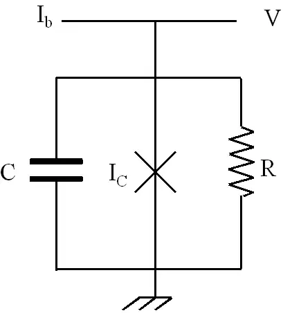

On the other hand, there is a model for superconducting circuits, and in particular for Josephson junctions in certain circumstances, that does follow this equation. This model is known as the resistively-capacitively shunted junction (RCSJ) model, and you can find OK expositions of it here and here.
Essentially, a Josephson junction is a very thin layer of insulating material in between two superconductors. The current through the junction, because of quantum mechanical effects, is given in certain regimes by $$I=I_C\sin\varphi,$$ where $I_C$ is a critical current and $\varphi$ is the phase difference between the wavefunctions of the Cooper pair condensates on either side, which grows at a rate governed by the voltage $V=\frac\hbar {q_e}\dot\varphi$ across the junction.
On the other hand, any Josephson junction still has some finite resistance (through nontrivial effects) and a very small capacitance. The simplest model that captures this is to put all three in parallel:
(Image source)
The current through the resistor is $I=V/R=\cfrac\hbar{q_eR}\dot\varphi$, whereas the current through the capacitor is $I=\dot Q=C\dot V=\cfrac{C\hbar}{q_e}\ddot\varphi$. If you hook up all three elements to a current source at current $I_0$, you'll get an equation of the form
$$I_0=I_C\sin(\varphi)+\cfrac\hbar{q_eR}\dot\varphi+\cfrac{C\hbar}{q_e}\ddot\varphi,$$
and this is of the form (1), where the force is provided by a 'tilted washboard' potential.
As it happens, the relevant limit for this equation is the overdamped case, because the "mass", $\frac{\hbar}{q_e}C$, is proportional to the capacitance, and while this is nonzero it is often (but not always) extremely tiny. Thus, you can make a mechanical analogy for this circuit, interpreting the phase $\varphi$ as the position of a 'particle', and here the inertia is often negligible.
