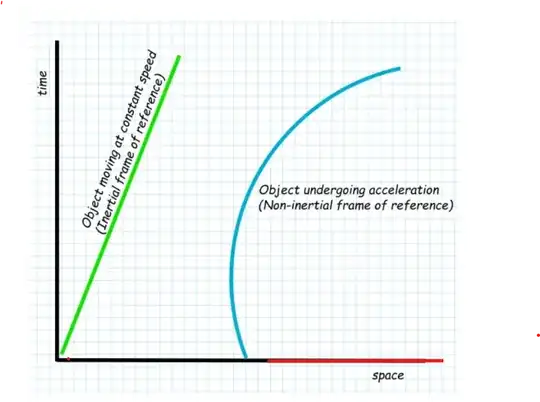

spacetime diagram
  1. You want the station observatory to be station-ary and so it will only move along the time axis in our diagram, upward along that black line. It is not moving along the space axis at all.
  2. The green line could represent our astronaut as she gets an initial boost to leave the station but then travels away from it at a constant speed. The station people could measure and plot her distance from them according to the time, e.g. five km per hour, and after four hours she will be twenty km away.
  3. The blue line could represent the astronaut's path through the grid as she gets closer to the black hole and begins to be subject to how it curves spacetime. As you can see, she starts to move more through space than through time. So, the observers will say that while another four hours has passed for them, she hasn't gotten forty km away yet, as could have been naively predicted.
  4. By the time the astronaut reaches the event horizon, the curvature demands that she is no longer travelling through time at all, from the perspective of the station people, and she is now travelling solely through space--as indicated by the red line. You can see that the two parties are no longer connected on the grid because the time and space paths have totally diverged. The station people cannot find the astronaut anywhere in their time.
Original diagram borrowed from: https://medium.com/math-simplified/how-the-geometry-of-spacetime-causes-things-to-fall-fd5e32c70082
